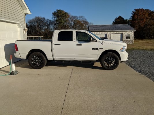

I just added the Bilsteins set at 2.1" yesterday. Got it aligned today and couldn't be happier. 81f3e9e7e44a293f2d081d854f98f2a5.jpg
Chad Lehman
Oct 8, 2018
Sunbury, PA
Rexdog...what year is your Ram and what are the dimensions on your wheel/tire package? Nice truck!
rexdog
Feb 11, 2018
62
42
US
Hey, thanks man, I'm pretty happy with it. The wheels are 20x10 with -24 offset and the tires are 305/55 Falken Wildpeak AT3w. I believe the tires are roughly 33x12s if I remember correctly. Oh, the truck is a 2015 Express.

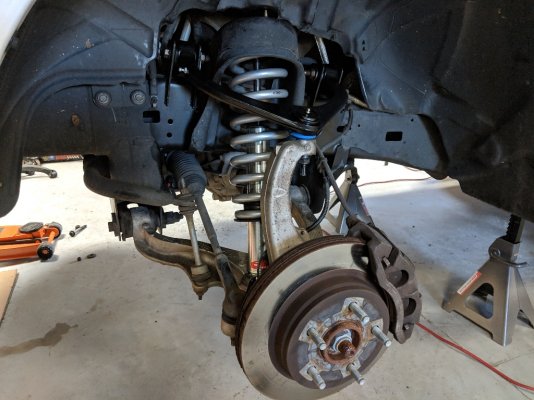

I just installed the Eibach struts and springs. Set at 2.75" Rides great so far.
Gary2
Dec 17, 2013
1,214
736
S Jersey
The slots on the shocks for the snap rings don't look like they are in the high setting nor does the picture look like 2.75 unless its just me? Are ya sure ya went the right direction with the snap ring , lowest is probably stock height ? I am guessing 2.75 is about the tallest setting. Looks just like a Bilstein shock
mike19950
Sep 5, 2017
233
209
Delaware
Yes I'm sure. The Eibach springs are longer than stock. You only get 2 positions to use with them. The lowest is 2.75. next one is 3.5 and the third can be used if you have heavy aftermarket bumpers installed.

I think your right, from my understanding if you buy the strut with the coils the minimum lift is 2.75", if you don't buy the coils then you have more settings.
Instructions with coils
https://eibach.com/us/pdf/14965
Instructions without coils
https://eibach.com/us/pdf/14963
mike19950
Sep 5, 2017
233
209
Delaware
did you install yourself?
Yes. I did have access to a wall mounted strut compressor to assemble the new struts. I didnt think the set I had at home could handle the Eibach springs.
