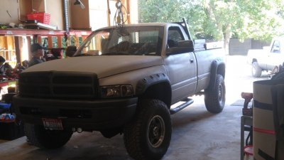

recently bought a 2001 Cummins. It’s on a. 4.5 inch lift in the rear and a leveling kit and 2 inch spring up front. And with the weight of the front the rear sits about an inch and a half higher than the front. Barely noticeable but it bothers me. So my question is, could i take out the 4.5 inch blocks in the rear and put 3 inch blocks to make it sit level, or would that not work due to the shocks possibly bottoming out in the rear?
thanks for any input

Thank you for the response. I think you read it backwards though! My truck sits higher in the rear and i don’t want to lift it anymore than it is. I would like to drop the rear end 1.5 inches. There is currently a 4.5 inch block in the rear. Could i put a 3 inch block in there to do that. Or would i have to get new shocks as well. Also i measured with just below half a tank of fuel! Thanks again

Wish i was a little tall in the rear .mine squats when i tow .im going to air bag it .too keep it level ..you should have no issues.putting smaller blocks .dont trim the u bolts till you find the right block combo you want .drive it to settle then check if the shocks bottom out when you jump up and down on rear bumper.if they do youll want shorter shocks .
