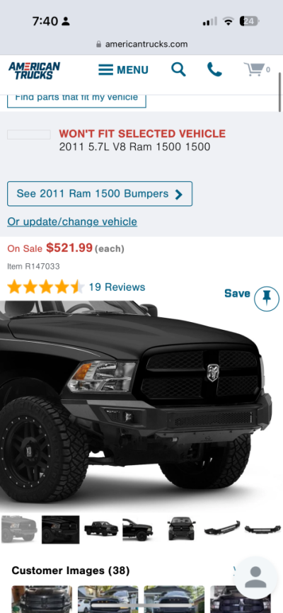

I have a ram 1500 2011 has anyone tried to put a 2013 After Market bumper on it here is the one I’m looking to buy. Any advice is appreciated. IMG_3735.png

You’ll just need to swap to a 13+ grille with the notched lower corners as well. Other then that it will all bolt up just fine.

Thanks man I appreciate it! Does all 13 grilles have the notched corner
