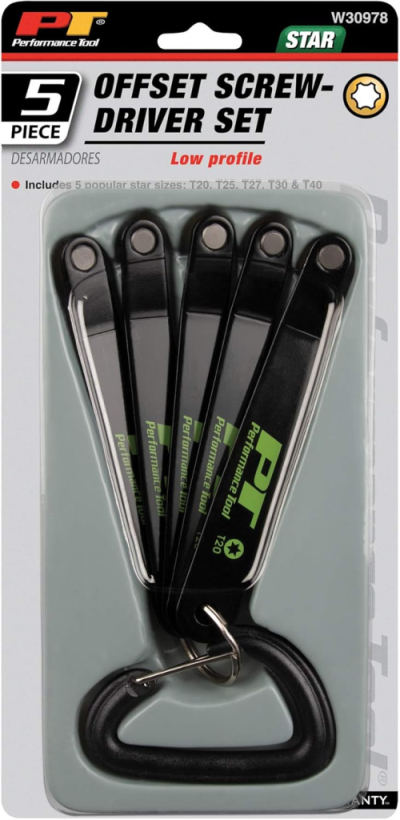

I was just looking at the pan. There is one T40 bolt that sits above the exhaust pipe. I have a 3/8" T40 socket. How did everyone torque that bolt down. My socket won't fit with a ratchet.

I didn't torque any of the pan bolts. Torx socket on a 1/4" drive ratchet is plenty, the bolts will bottom out on the sleeves pretty easily. Lot of posts about people snapping these bolts from overtorque.

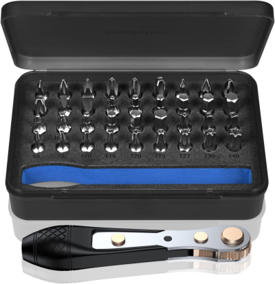

I have all these bits and then end up using a 1/4" socket to hold the bits and curse when it falls out every time I use it. I need to grab one of these little ratcheting drivers.
Put a small piece of black tape on the end of the bit before you push it into the socket,that usually holds them in the socket pretty good
