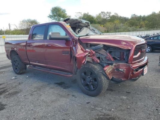

Just pulled the trigger on a rolled over 2018 SLT 2500 with a few extras — heated seats and the 8" radio ect.
That means the Limited seats will be 100% working.
I found a writeup here how to make a push button and keyless entry upgrade, so shouldn't be an issue.
My biggest fear now is getting the dual-zone climate control to work.
Has anyone activated dual climate on a lower-trim truck before?
Do you guys think I should document everything and post the whole process here? or it has no value to the forum?

It's doable, but you'll need a conversion harness from M2Mods (forum member @Mpgrimm2 )
Definitely document. It'll help you too when you hit a roadblock.

in order to use dual zone you need to do something with the blend doors, or something. SitKneelBend is right M2Mods can get you a harness to work and has the writup (i think) that tells you what needs to be done. I with his wire harness have the single zone auto temp control working in my truck. it works well.
