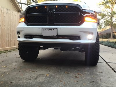

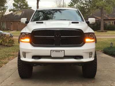

That’s why I bought the genie. No stress, no phone calls, no confrontations at the dealership and no wasted time. I had DRL’s in 5 minutes in my own driveway, so funny that I was able to do what the dealers couldn’t or wouldn’t, I was *****.

RAM Cares (about their dealers).
Seems like the trend - they can help but in the end most of the time they side with the dealers. They will suggest trying another dealer, who will most likely tell you the same thing, and again RAM cares will side with the dealer.
I cant fault them 100%, because its not like they are with us and our trucks, but a little more nudging of the dealers we go to would be more helpful than just automatically agreeing with their assessment.
Although I would be pretty pi$$ed if a dealer basically said we'll take your $90 and give you nothing in return.
