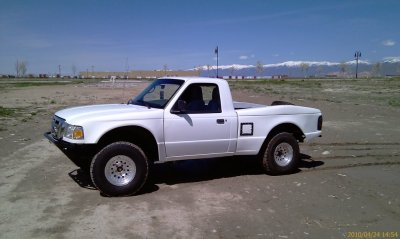

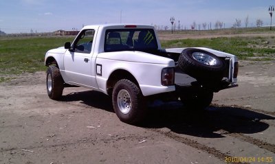

The stage 1 kit from KORE is a 3-3.5" lift. They use the Bilstein 5100s similar to the leveling struts but they are revalved and have an extra notch machined in them for the increased clearance. That kit is only $2,000 and gives you the same lift as the ram runner. Then you could just use some wheel spacers to get some more track width with front fenders, a lightbar, and pull your factory bedsides. Fairly cheap, will look like a mild prerunner and still able to drive offroad hard. Or even just the regular Bilsteins with an .125" steel spacer on top for ~2.375" for a low budget. A lot of prerunners sit low in the sagged position as they use most of their travel in droop.
http://www.koreraceshop.com/dodge-ram-1500-suspension-lift-kit-KORE-Prerunner-Series-09-10-2.aspx
I had 2" wheel spacers with full fiberglass on my old ranger and I jumped it and drove it as hard as I wanted and had no issues ever. As long as they are good quality hubcentric spacers you'll be fine. I'm thinking of going this route with my '07 but gonna look into these fenders as they're only $280 and fab my own lightbar/skid plate.
106475 Extreme Dimensions 4.5" Bulge Front Fenders for 02-08 Dodge Ram at Andy's Auto Sport
Pulling bedsides...
http://www.prerunnermaniac.com/Prerunners/Prerunner-Tech/Flared-Bedsides-for-your-Prerunner.php
This thing got looks everywhere and was fun as hell to drive but a fraction of the cost of a real prerunner.
