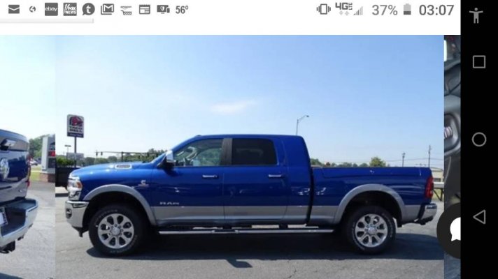

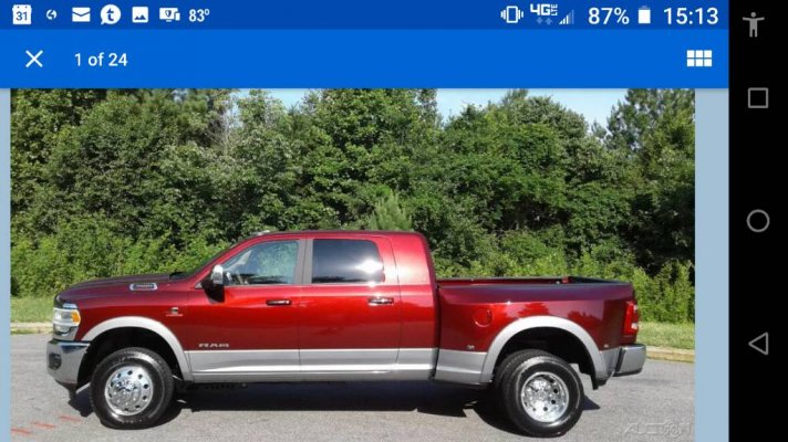

My two color choices and models I narrowed it down to06c653136c75752b1f8dcebec7eb5043.jpg2ca552134c573e919b62c5450ddf0372.jpg

depend on how much pulling you plan on doing if you think about a dually will displace the weight under load better. so the wear on your tires will probably be a little better on the dually and more stable with duals. getting around parking lots is the last thing on your list they both drive like a boat lmao. If i was to retire and plan on doing a lot of pulling i would run with the dually mysely. the non dual truck will do everything you need only hualing 11.5k no problem with either of them. definitely post some pics with you get the keys
