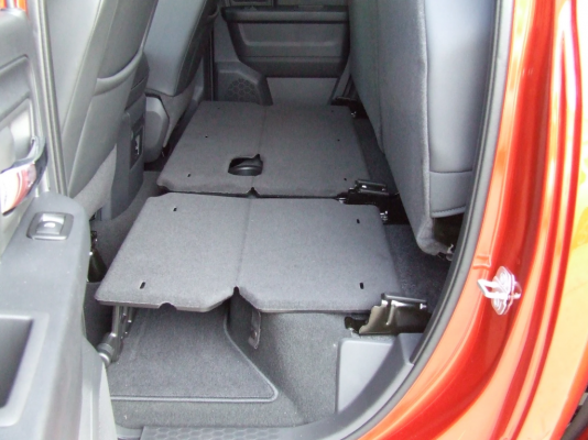

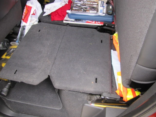

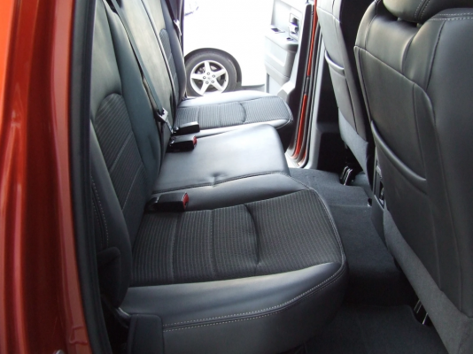

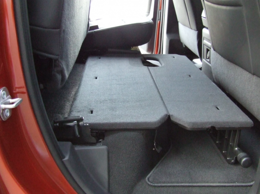

First thing for you to know.
The seats are different, between the Crew & Quad Cab
If no one usually sits in the back seat, i guess you could use either size
Crew Cabs would have all the holes that you need, for the Crew Cab split seat
Same for the Quad Cab, for Quad Cab split seats
