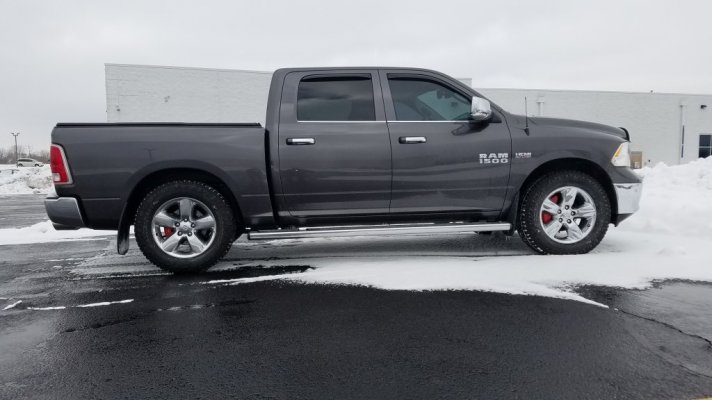

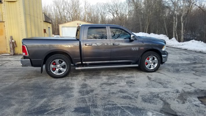

They're great springs!!
I'm super happy with the looks and the ride!!

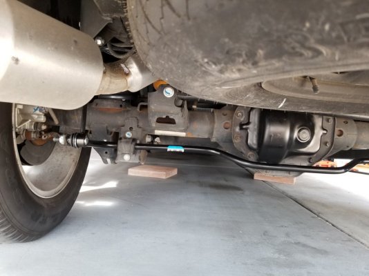

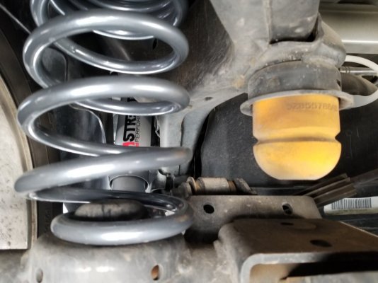

FWIW I went 2 extra steps other than just Pro Suspension 272920 coil spring install. I took Belltech up on their shorter 2214FF Street Performance shock for slightly lowered trucks. And a tip for anyone and everyone on here with the sway bar issue that arises. RockAuto of course has a bazillion Chrysler parts on there, so I sat and referenced vehicle rear end links for quite a bit of time and realized the Jeep Commander '06-'10 used the EXACT style link as our RAM, they are just shorter length (-1 3/4"). MOOG's K80468 link would be an exact example of something you could use. Installing a set levels the sway bar out perfectly again, without having to spend serious coin on "adjustable links", which are nice, but I just was convinced unnecessary if I could figure a $reasonable$ work around. Anyway, something I successfully attempted and wanted to contribute here, I hadn't seen that solution preposed around here yet.
