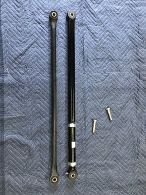

Here’s a pic of the stock panhard bar next to the Core4x4 bar. The stock bar is a hollow tube but the Core4x4 is a larger diameter and solid.
The stock sway bar was also a hollow tube but the hellwig is solid steel.
