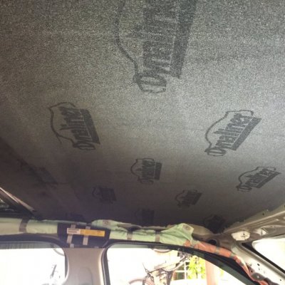

I used dyna mat all over the back wall...every inch....next I ordered dyna liner 1/2" thick....it's self adhesive and easily trimible with scissors...I covered entire back with....I left the vents exposed but put a breathable layer over themso air will still enter and escape..I treated the entire interior and door panels as well as headliner...the dyna liner is the best... I ordered in 1/8", 1/4", and 1/2" thickness. Place over the dyna mat...I also treated the entire floor in dynamat and then placed dyna pad over it and then reinstalled carpeting.....truck is tight like recording studio...lol
Here is some pics

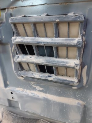

After choking on a cloud of dust, I pulled the rear seat out and discovered that half the flaps are missing! Any suggestions?20190512_120603.jpg
