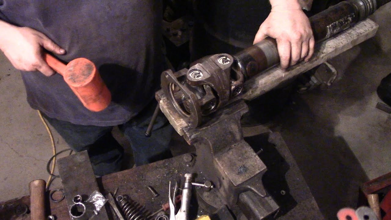

This past weekend I swapped the U Joints in my rear drive shaft chasing a vibration while at 50-70mph. Took a considerable amount of vibration out, but also in checking things out noticed my front drive shaft has a little play in it on rear U joint (the fun to grease one!) and wondered if anyone has done this? Pointers would be helpful as I've done plenty of standard U Joints, but not one with a ball between them. Any pointers?
Using this site for understanding of parts:
Is for older Ram, so different size of double joint, but this video is basically same process to replace the parts:
From other research I've done my understanding is you can take the front drive shaft out, and no harm/issues for normal driving (except you don't have 4x4) so will probably do that first to break it down and confirm the right parts before I start ordering. Mine has the flat face plates on each end so won't be leaving the transfer case or front differential open/exposed.
Anyone who's done one of these please let me know any gotcha's you care to share.

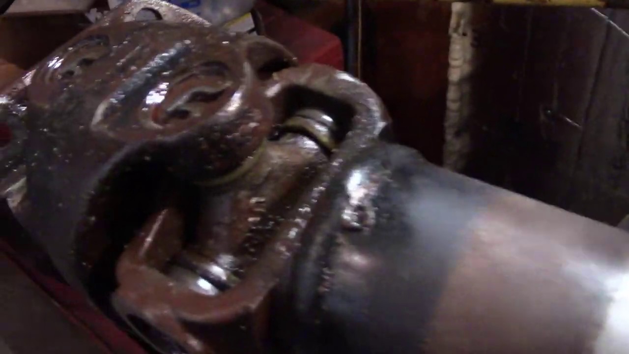

One item I see up front is how to get the CV Ball out of the yoke? This is the one that has the weird grease fitting you have to find and grease at each oil change.
Found this as one option:
At 27:07 mark
or
you could buy a whole new assembly:
So rebuild it for $47.98 or buy a whole new assembly with CV Bearing/Spring/Seal already installed for $199.98
You're still going to need the other seal either way listed above for $12.98
