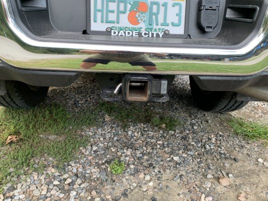

Which ever engineer designed this is a absolute moron. I have all Bolt locks, we tried 3 of my cousins as well today. All the locks block connection of the s hooks. Idk what to do… brand new truck and might have to replace the receiver with a Curt or Draw Tite. Had no idea I’d run into this issue when I bought it. Seriously I’m pretty pissed off about this. … I know you “could” connect on the side but either way s hook up or down tugging on it puts it at a very bad angle, I could only imagine what 5000lbs of force at highway speeds would do to the S Hooks, would easily twist them off. Then god forbid The coupler ever failed and s hooks failed from being hooked improperly and a fatality occurred I’d be the one in trouble for not properly securing the trailer, negligence.
Any of you guys have a work around for this receiver?

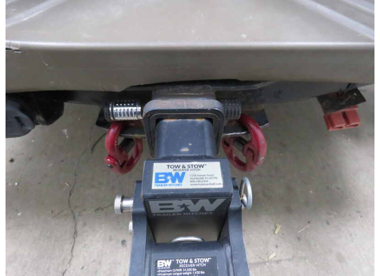

My safety chains work fine with my locking pin. Plus the emergency cable also hooks up on the lock side. If I needed more room I’d use two heavy shackles.

I can't seem to find a pin lock that will allow better access to the safety chain holes, the holes are recessed and close to the receiver tube. The smallest profile pin lock I can find is T shaped, I can slide the pin to the left and right to gain a little more access to the chain holes and it works but is a pain. Is RAM using different styled receivers in production or is my 2022 receiver a unicorn?

I would just add a screw pin shackle if I had a problem. Trailer chain hooks and hitch lock designs vary widely, so hopefully owners are capable of selecting compatible components so they won’t become the actual moron.

I got a co worker with a 21’ Limited same as mine +/- a few options his receiver is totally different than mine. It’s oem for a fact. These receivers must be coming from multiple factories. Just browsing pics online found another one just like mine but the hole for the pin is like a inch and a half out farther than mine which would allow access for the S Hook no problem.

If you can’t fit the S hook on how the hell are you gonna fit a shackle on…. If you did have a 3rd party shackle on and it fails and something serious happens who’s getting blamed for improperly securing the trailer… Then on top of it you would be extending the length of the chains that could possibly create a safety issue as well cradling the tongue of the trailer.
I’d rather not take short cuts or do work arounds a lot of bad s*** could happen.

I use a Dring with the screw in pin it extends holes outside the receiver tube it doesn't extend it too much; they are very strong!!!

Here’s a picture. The lock just rotates up to clear the hooks. The gray boot covers the lock.
I don’t remember where I bought it.
