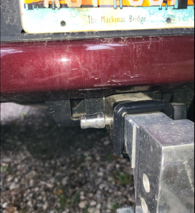

Here’s a picture. The lock just rotates up to clear the hooks. The gray boot covers the lock.
I don’t remember where I bought it.
This receiver is different. That’s the style I had on my GC.

I got a co worker with a 21’ Limited same as mine +/- a few options his receiver is totally different than mine. It’s oem for a fact. These receivers must be coming from multiple factories. Just browsing pics online found another one just like mine but the hole for the pin is like a inch and a half out farther than mine which would allow access for the S Hook no problem.
That has to be it, different suppliers, different designs. Whoever designed this method for hooking security chains has never towed. This is what my 2022 1500 receiver looks like. It is very very difficult to get the chains to hook. I'm thinking of pulling the receiver and adding an aftermarket or adding my own.
