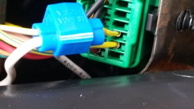

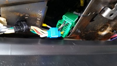

I have a 2015 3500 Dually and I'm about to install a set of Recon's Big Rig Ice lights. If anyone has installed these lights on their truck, I need to know which wire to tap into for the ice light function, and exactly where to find it. TIA

Remove the Dash Side panel. You should see a green connector. The wire you need to connect to is yellow with a violet stripe.
