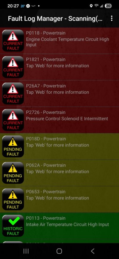

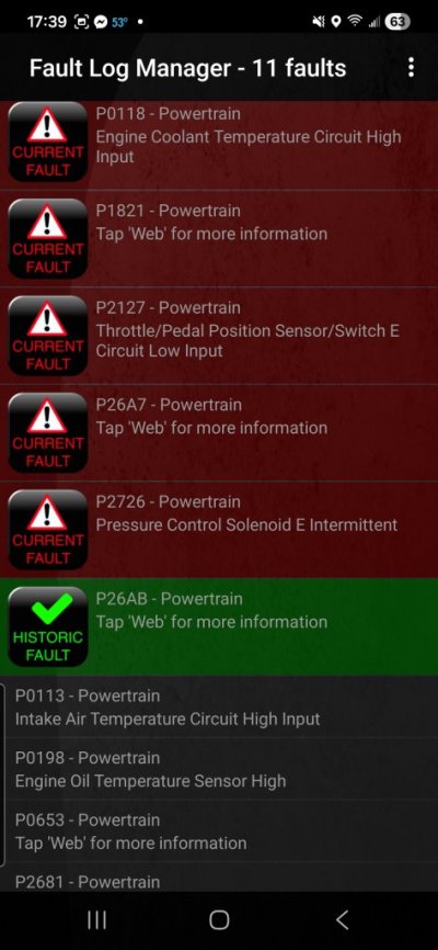

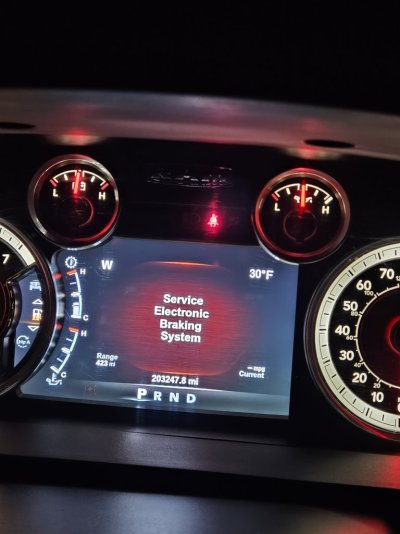

I have a 2015 Ram 1500 that started with electrical issue I believe. At least 3 months ago when starting the truck I began having an issue where after the dash lights complete their "test", just about all of them would come on and stay on. It'***** and miss when I start it. Sometimes they the issue pops up, sometimes it starts normally. When in this error state, the gas pedal won't function, after a few seconds it will start to idle a bit rough. If it goes into this error state, if I shut off and restart eventually it will start normally without any lights or issue. It may be one time, it may have to be a few times. Back in November, before this started, I had a MIL light (P2681) that read as a engine coolant bypass valve circuit open. I thought it to be a bad valve and changed it with a NAPA replacement. The MIL light went out for about a week and then returned with that same code. About 3 weeks after, this new issue started. I'm not sure if the valve one was related to the current issue. I tried to research the current issue and thought maybe a bad ground. I went to all the grounds I could find and cleaned them with no resolve. I figured I'd take to the dealer to troubleshoot and after 2 hours time they said the grounds were good that it was the PCM. They quoted $1600 for the PCM + labor for them to replace it. I took it home and ordered a PCM from Flashmasters and replaced it with no fix. Speaking to another mechanic it's felt it's not a ground issue because if it starts normally, it won't go into this error or failure mode while driving. At least not yet. He felt it seems to be something not starting/turning on/powering up as it should all the time. Sort of like a sticky relay or something. I have seen that the Rams have a potential for a TIPM failure and he suggested that might be the next step. Could the BCM be the culprit? Or I hate to think there is a wiring issue hidden somewhere. The truck underneath is pretty clean with very minor corrosion for the year so I may be wrong but am leaning toward the wiring being ok.
I am hoping to get thoughts of you all that have more experience or have heard of this issue/fix. I'd rather not just keep throwing parts at it blindly. Attached are some photos of a few of the warnings that come across the dash, but there are several more including service air bags, trailer wiring, etc. that I didn't include. The codes are from a few different times. They are generally the same when they come back after I clear them.

While the battery is a possibility, usually the codes are "lost communication with x, y or z". Your codes all seem to be "intermittent circuit high" or just "circuit high".
All of those unrelated systems showing "circuit high" faults strongly indicate an open circuit somewhere. Somewhere that powes a lot of different stuff.

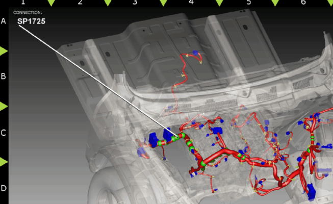

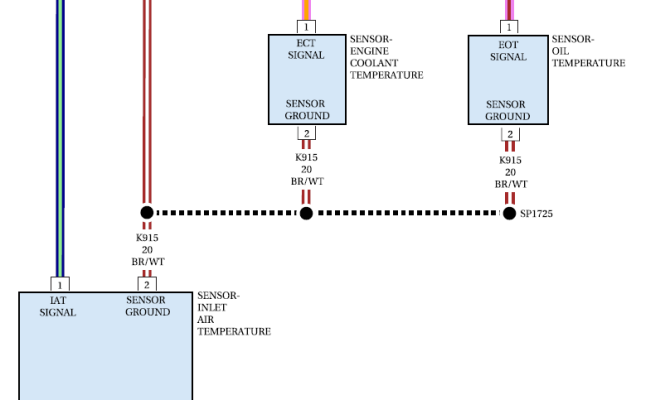

Here are 3 sensors that have fault codes, that all share a common sensor ground. The circuit K915 Pin20, brn/white all go to the common splice SP1725.
SP1725 is here:
So, i'd inspect the wiring harness in that area, and look at nearby grounds
I'd bet that some or all of the other systems showing fault codes have grounds that pass through that splice, and use the same ground location.
