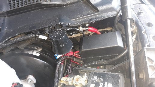

Has anyone installed a small remote fuse box for accessories? Where did you put it and what materials did you use? Thanks

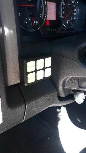

Mine is from 4thGenRamElectronics from facebook. Looks like the one Kalill put in, I mounted mine in the same location and its controlled by a oem aux switch setup.

Thanks guys, That’s a great looking relay box, I was looking more for a fuse box
