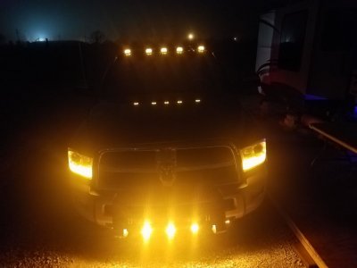

When I replaced the white factory ones with aftermarket smoked, they were hard to get off. I grabbed low at the base and twisted back and forth and they eventually popped off. No adhesive from the factory. The after market flickered and burned out in just a few months, so I made my own. All work is done from the top. 30 minute job. Take your time and make sure to seal everything good.
