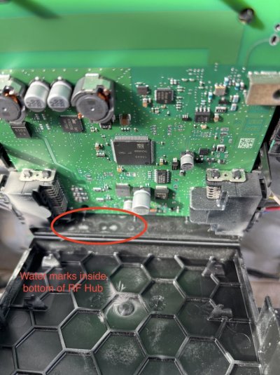

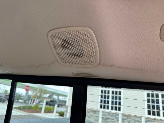

I'm new here, but thought I'd share a quick write up of my leak prevention efforts on my 2020 1500 Laramie. After basically getting the middle finger from two dealers and RAM corporate, and another "atmospheric river" storm about to hit southern California, I decided I had to take care of this on my own. I've read a number of horror stories about the RF hub and the ETorque battery being damaged. I have minor stains in my headliner, and I've also had wet carpet under the rear seats, and I've physically seen water dripping down from the crack in my rear window frame during the last storm. I placed a rolled up towel behind the headrests along the bottom of the back window and the entire passenger side was soaked after one night of rain. Since there are basically four areas that can be the source of the leak, and evidence shows I have at least two of them, I decided to tackle them all at once.

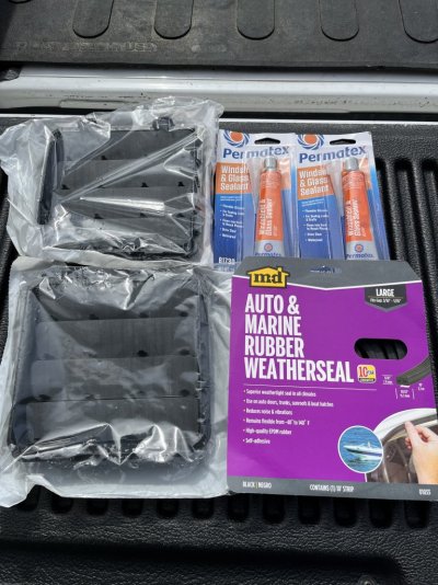

Here are the materials I used:
2 pk Permatex 81730 flowable silicone glass sealant - $12.33 on Amazon
MD Auto Marine Rubber weather seal 01033 (5/16 height x 19/32 width) - $11.78 at Lowes
2 cab vents (Exhauster, bodyside aperture part #68323648AB) from Mopar Parts Overstock - $26.24 ($7.72 each, $10.80 shipping)
So basically $50 for everything. Much cheaper than the $200.00 the stealership wanted just to diagnose the leak, and I'm sure much cheaper than the percentage of the repair Corporate was going to make me pay for the window replacement. And based on other's experiences, replacing the rear window may just result in the same issue down the road.

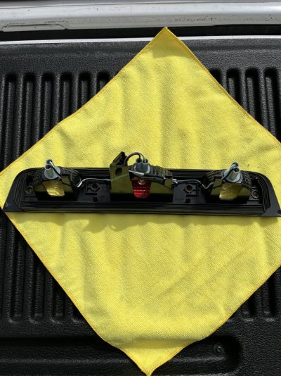

For the 3rd brake light, I removed the old sponge like gasket and used some Goo Gone to clean it up. Not sure that was necessary, because the weather seal adhesive seemed pretty strong, it might have been ok to just put over the sticky stuff that was left. You may have to zoom the picture a bit to see, but I used one piece to go from the bottom of each side of the brake light across the top, then used another piece between them along the bottom. My thinking was that the seams are vertical, and somewhat protected, as water flowing down (gravity) would roll off the outside without seeping into a horizontal seam. I did trim a bit off the edges at the bottom as well, to follow the contour of the original gasket. When I put this back on you could tell it was a more robust / tighter seal. I applied pressure with one hand as I tightened the screws with the other, careful not to overtighten them.
Finally, I removed the rear seats to access the rear cab vents. First of all, how in the world does so much dust/dirt get in back there? My truck is no pavement princess, I spend a lot of time on dirt roads going hunting, hiking, etc., but I was surprised at the amount of dust behind there. But there were also obvious drip and water marks in a few places, and evidence some water had actually gotten inside the RF hub - not good.

My headliner is stained so I’m thinking the third break light moreover the break light is out or got wet can lights still work. It was also damp on my rear driver side too so maybe the vets as well? I have a 15 ram with 46k on it, would this be covered by warranty?
