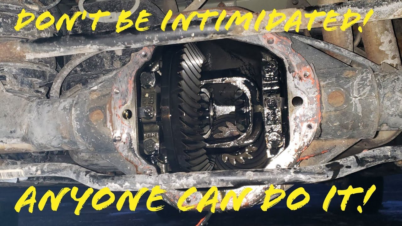

watch a video or two on replacing the wheel bearings.
This guy is an amateur, but he got the job done, with a misstep or 2
Replacing Parking Brakes pads
( do not lay your axle down, always stand it up )
