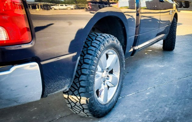

If you want the look/functionality of a/t tires without the noise on the highway, check out the Nitto Ridge Grapplers... love mine!

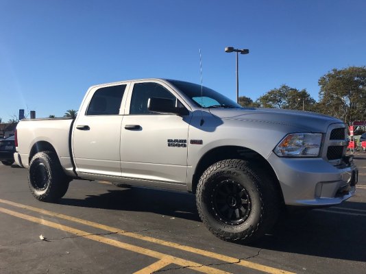

You can try Falken AT3W, they're not super expensive and they wear down very nicely under the 1500 weight.
This were 315/70/17 E rated on a 2.25" front lift. They wear down 1/32 every 5k miles, and in this size they come new at 19/32. They're on the heavy side at 74lbs though so if you want big tires you can expect some MPG drop.
45615561205_1e4ca10c25_k.jpgUntitled by RAM RSM, on Flickr
Also ran the same tire with the Rancho QL 2" front
42334323440_48a87ce83a_k.jpgUntitled by RAM RSM, on Flickr
