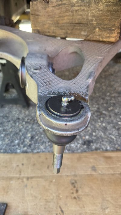

While you are in there doing the shock absorbers, check your truck's lower ball joints. After 175k miles most of the suspension and steering joints were still good on my truck ...except the lower ball joints were shot. So it's worth a look at them. You almost need to pull the stud off the knuckle to 'really' check them. A simple puller (which you can rent at a parts store) makes removal a piece of cake. No beating or swearing.
If your truck has plenty of miles on it, and needs B-J's... you might as well buy new lower control arms. It's a LOT of work to replace B-J's and bushings. You have to *want* to do it.
New ball joints & shock/strut bushing:
