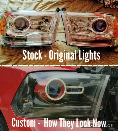

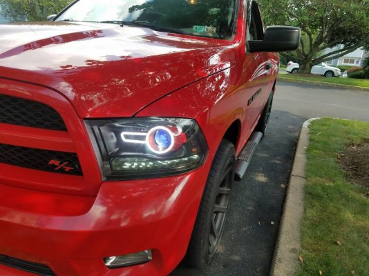

Did the above headlights myself ... separated , painted and installed switchback halo..... Worst part is taking apart and then resealing
I’ve done a couple sets after that for my buddies ... huge pain in the ass with one lights ... aftermarket eBay lights are much easier to separate ... I’d suggest using those and repaint to ur color ...
I have this set in my truck now which are sick. I paid a guy on this forum to make em for me
I then wired the halos to. A switch in the cab that way I could run them independently of each other . The rigid pods are ridiculously bright and have clean beam.. have yet to be flashed so I know they are aimed correctly ...

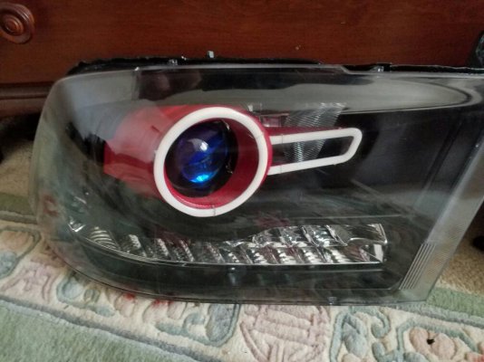

I've had 5 sets of the "oem style eBay quads" and every single set for perfect and didn't have one single leak.
Trust me if your opening them up and have to reseal them, there is absolutely NO point to buy the oem ones because no matter if their OEM or eBay replicas it all comes down to how good of a job you do revealing them. The aftermarket eBay ones don't leak from anywhere except maybe the seal on the lense so if you are going to have to reseal them then you will be fine.
Plus if you mess up and ruin the lights you won't be out as much money as the OEM ones cost double.

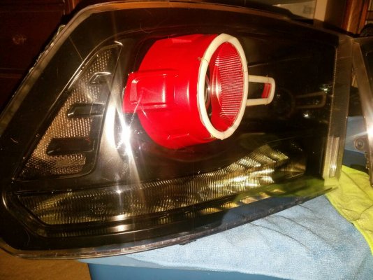

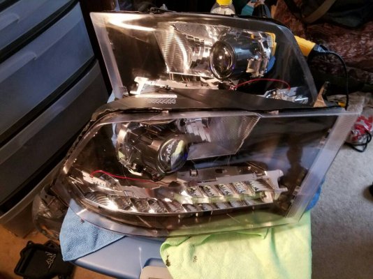

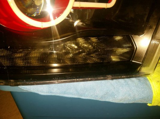

I custom built a set of 13+ projectors and opening them took hours. It was such a hassle. I had condensation issues in one lense after I resealed them. A quick bead of black marine sicone around the groove where the sense meets the housing and I threw in some gel silica packs I made myself and I havnt had a single drop of moisture in them for 6+ months now.
I've built a couple sets of the eBay quads for people and nobody has had any fitment issues or anything at all.
Here's a couple quick pictures of the 13+ projectors I built for my truck. They are going up for sale later today so I can build something new.
