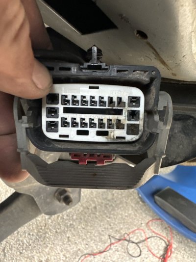

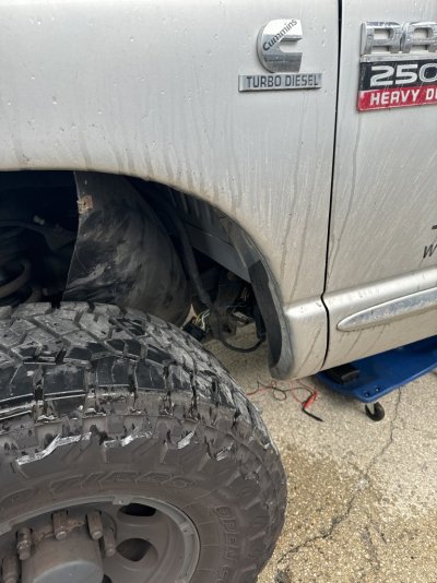

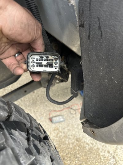

Hey guys, I found the solution. For me, it was the plug underneath the driver door that connects to the ecm or whatever. The ground and rear taillight pins were corroded into nothing. I just cut those two wires off the plug and splice them back together

Hey would you be able to tell us the color of the wire you spliced? and I guess if you can circle which pin it was?
