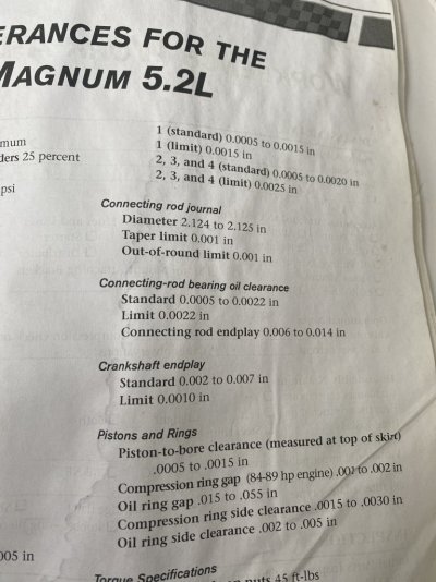

I am rebuilding a 5.9l magnum but can't find what the rod bearing clearance is supposed to be. Looked in the FSM but maybe I missed it. Any help?
