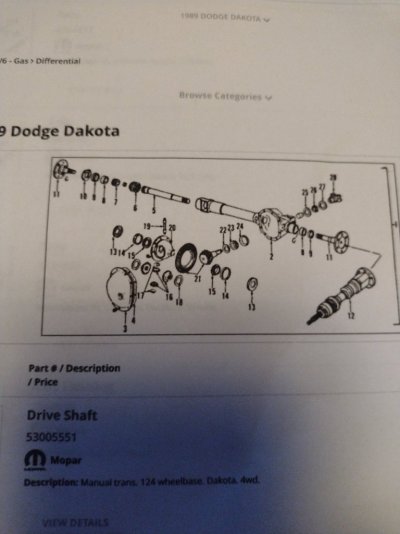

I have a 1989 Dodge Dakota 4x4 which I use on the farm for feeding. I need to remove the passenger side flange that holds the CV which is bolted to it. How do I remove the flange so that I can replace the seal and bearing that is behind it. I know all the parts are not available but I do have a salvage front differential for parts. I need help trying to get the salvage front end apart so I do not destroy the bearing and seal on the salvage axle. All videos do not show a bolt on CV axle which is what I have. That is why I am here. Any help would be appreciated. Number 11 is what I am trying to remove.17737928203398874805914290038151.jpg

Looks like their might be a retaining clip shown between the central housing and the #8 part. I could be wrong though, hard to see.
