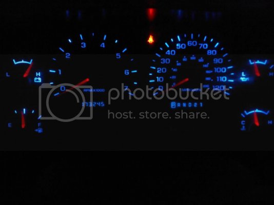

just did my dash with the blue film. have plenty of leftover if anyone needs any. pm me and let me know. as far as a price goes, i only paid 10 bucks for the whole sheet and i have no use for it so someone just as well use it, not charging anything for it. heres a couple pics.

so this would change the color of the guages?? how much would you need for just the guage cluster, i would like to try it
for the gauges all i did was change the stock bulbs out to blue led's, no blue film needed for the them. the odometer and PRND21 however needs the film to change the color since you cant change the bulb for it.

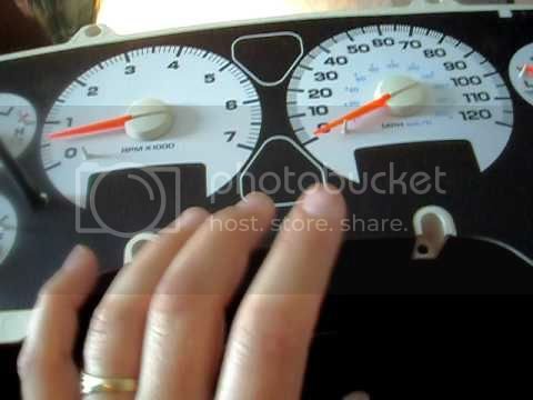

on mine i only did the gear area and odometer. wanted to do the whole thing but couldnt figure out how to get the overlay off of the cluster. i was going to put the film under the overlay to hopefully make the gauges a little darker of a blue.

oh so you had to take the cluster apart??? lol i dont follow how this stuff is applied lmao

just had to pull the cover off the cluster so it looks like this...
then lift up the overlay and slide a piece of the blue film in place where you want it. when you put the cover back on it will hold everything in place so it doesnt slide out. hope this helps some, im not very good at explaining things. haha
