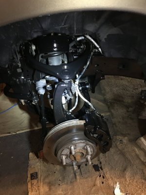

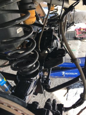

I removed the liner and painted the wheel well lip as well.
Then do fluid film or Krown rust proofing every year or two depending on how much salt they use in your area.
As for working on it after, I would definitely do your oil change before getting the film out on. Or do it a few months later. It’s not that bad though, unless you’re changing out the whole suspension as it will have a film over the metal. But bring a new truck I can’t see you underneath more than once or twice a year.
Side note:eek:nce it’s sprayed don’t park in your garage or force way as the oil drops for a few days and will stain the concrete.
As for what 2010 infantry vet said, don’t use bed liner or any hard coating. If a bit of it cracks or chips which it will. You will get rust and you won’t know it. Then a couple years down the road it all flakes off and you have rust everywhere. My sister had it done to her car and it rusted to ****. It does work well for sound deadening purposes.
This is all assuming you’re keeping the truck for years.
This is what POR looks like when it’s done.
This is a 2013.
