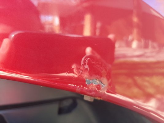

I have this small rust spot, That my dealer covered with paint pen - It just appeared after the last winter. ( It was flaking, I lifted the flake, and this is what it looks like )
I have went to every single auto body shop in my area, with drastically different prices. Some people say just use a paint pen, Some say they will sand it, and repaint, the dealers say they would replace the entire panel ( rear wheel, right panel )
The quotes range from $1000, for a sand and paint, all the way up $3000 for a full panel replacement, front bumper respray ( rock chips, normal wear n tear ) oil coating around wheel wells, and a full buff / scratch fix If they see any other minor scratches.
My question is, What would you do? So far my options are.
A) Sand down the spot, Dealer paint pen, Seal & buff ( I just bought an auto buffer ) A quick fix until I'm ready to put up $3k
B) $1000 for a shop to do the same thing.
C) $3000 for a local dealer to completely replace the back panel, respray the front bumper, & oil coat
D) Get a trade in appraisal and look for another vehicle.
If I traded in my truck, After looking online it seems like used truck prices are really high? If I wanted something similar, I would be looking at around $35k - Even if I put in $3k, My total price would be $29k.
Hoping to get opinion's from people who have done this before, Trying to weigh all my options!!
Thank you, If you have any advice that I have not considered - Please let me know.

I would go for sand and paint... a body shop should be able to make it look pretty good. And something else will likely show rust before long anyway at that age so I wouldn't want to pay $3k to fix. I will be fixing a couple spots like that on one of our older cars myself with rattle can paint... but it's not nearly as nice a vehicle as yours.

Do you think sanding, and painting can help stop the rust?
The dealer said if I dont replace the entire panel it could travel - and claims the rust could already be under all the paint. When I flaked off the paint, it does not look that bad? ( I also dont know a lot about rust )
My mom, and best friend told me to sand it down - repaint and buff it myself to save the few thousand - Just like you suggested. its such a small spot - smaller than my thumb nail.

There is almost certainly more rust than you can see. But if you sand out a bit further you should be able to get it all. There are also cleaners and chemicals that you clean it with before priming. If you do that the rust should not come back.

Use a rust converter, not preventer.
Then touch up paint.
Thank you both so much for the advice! I am going to try and do it myself - and pick up the exact color from my local dealer.
I have purchased an auto buffer, Rust Check Rust converter, Meguiars scratch removal, turtle wax chrome polish & rust remover, 120 - 7000 grit sandpaper kit - Just need the paint from the dealer when they open on monday.

Looks like the paint has bubbled with some rust, get that gone before you start and hit it with rust converting primer ....still feather the edges and get it so you are able to blend the edges in.

Another voice here. Unless you remove the rust, it will come back. Removing involves either cutting it out or possibly sandblasting. You won't know what you have until you get into it, but just sanding or using chemicals won't be worth the time. If you want it to last go with a reputable body shop who will cut it out, properly fill it in and then paint and blend to make it look as good as possible. You're talking a few hours plus materials so $1k isn't unreasonable.
Otherwise, scrape it, paint with some Rust-Oleum and throw some fender flares on. Good luck.

I wonder if there is more than just that spit they think they need to fix. I see the rusty bolt in background, it is possible that it is inside between panels. Work to repaint is labor intensive. Lots of wet sanding for the stone chips and feathering back, and if the areas off the hood over the lights need work, it is essentially the whole front. Plus the work on fender if done right, is expensive. Right now, you are still in a tight time with vehicles coming out of winter, I used to see some better deals in early fall when people are not normally thinking auto body ( they think why spend money now when winter salt is coming, just wait for spring) so maybe check then. I also suggest checking at car shows who people use. I found a person who color matched a whole 8' bed for me for $500, including sanding and a bit of repair. I told them I could wait until they were in between jobs, and got it done right after Christmas when they had a slow down. Good luck.

I wouldn't do anything until I pulled the rear wheel well liners out to have a look from the inside. It's the nature of the beast with a 9yr old vehicle, especially if it sees rust belt use.
If both sides are clean under the wheel well liners, that $3k quote for a new bed side is a good price.
Any other repair is going to be temporary.
If it were my truck I'd try to knock off any loose bits on that spot and cover the spot with a rust converter product like rust bullet or POR15 and top coat it if it's supposed to be top coated.
