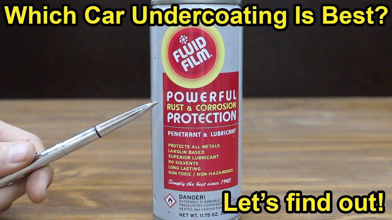

Always stuck to an oil/wax based coating such as Krown/Fluid Film/Woolwax. They will continue to creep into the metal and provide a very good coating while not causing any negatives

I’ve read mentions of dealers voiding warrantees for undercoating, obviously as it relates to the issue ... I’m here in OH, smack dab in the middle of the rust belt, and the home of too much road salt ... Fluid film, and to a lesser cheaper, messier end, oil spray, are king around here ... Oil spray for $60, fluid film $100-$125 ... FF is worth the extra money ... Should be able to Google your area, and a shop with reviews should pop up
