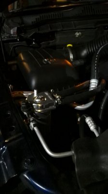

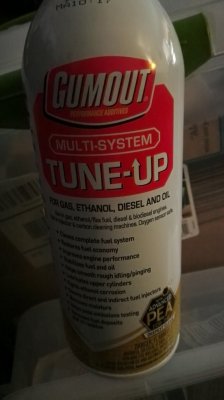

I have been through the seafoam cleanings in all my vehicles for years, 15+. What I found is 1 out of 5 I did, I had issues, couldn't start after, etc, most I did threw a engine code but resolved once reset. Did I notice a difference? On a 02 ls1 camaro due to flatter pistons, I did have knock before seafoam and on a 96 mustang gt, after seafoam cured knock. Now I stopped using seafoam and found P.E. A fuel cleaner is best, redline s1, gumount complete fuel system tune up, etc. Specs show redine has most P.E.A, Chevron is ok too. If I were you, depending on miles, my 13 Ram 5.7 with 40k miles, one bottle of the gumount made noticable difference. Then I put a cheap good quality catch can on to stop having oil blow by. Now. Gumount is like $6, redline varies but around $11. Catch can on ebay, with braket for ram 5.7 and drain lever is like $60, I would buy good fuel lines 1/2 inch and 2 (1/2 inch) brass connectors, you will be happy after you see all the oil it catches. I put a $35 billet can with dipstick, is fine, but ones with braket are pretty cool and get great reviews. This photo is after less than 100 miles freeway cruising, no racing and look at the oil caught. Also the gumount I used, honestly this is first time on any vehicle I really noticed a big difference running fuel cleaner. Around 1/2 to 3/4 way through tank felt a smoothness and power gain that was very easy to tell. Right after that I changed my plugs, PVC and put on catch can. Gain may have been dirty plugs who knows, but even after plugs I felt difference. For the price and how effective p.e.a is I am going to start running it every 4th tank.
Also, my oil isn't dirty lol I run mobile 1 EP with lubeguard biotech to add extra moly to my oil, the biotech is super dark black so darkens oil.

Gum out regane complete fuel system cleaner is 6 ounces, and like 10-30% PEA, and Redline s1-1 is 15 ounces and less the 30% PEA. I bought a case of twelve redline s1-1 off amazon a while back for a little over 8 bucks per 15 ounce bottle. Just for comparisons.
