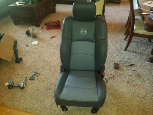

The Laramie and Sport seats are completely different than the Big Horn seats as far as the actual cushion and lumbar support and bolster. They are a high back bucket. They also look completely different if you were to compare them side-by-side. I installed the Laramie seats in my truck and they are extremely comfortable. As far as the seats fitting you in your truck any 13 and up Laramie seat will be at direct fit all the wiring in your truck is present and correct. If you're buying any seats for your truck it is extremely important you make sure they have the airbags in the seats. Some of the 4500 and 5500 trucks do not have airbags so even though they are the correct year if you install them in your truck you'll get an airbag light warning. Make sure the seats have the little tag on the side like yours do that says SRS. This is a picture of one of my Laramie seats after I reupholstered it if you look at it closely you will see it's completely different shape than your Bighorn seat.abbdfda4f779457c952218890e7edeec.jpg

Yeah, I can see it when I look at my truck versus your picture. Any idea if the longhorn are the same as the laramie? Been loosely looking for awhile and found a pair of longhorn front seats (leather/heated/memory) for ~750 shipped. I was going to reupholster my truck either way so them not matching isn't a big deal. Appreciate the reply.
Yes the Longhorn seat is the same design. it's just a tan leather instead of the black leather on a Laramie or Limited.
