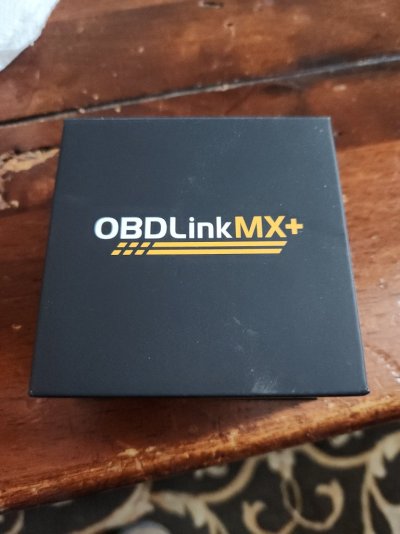

Instructions say to plug into OBD port just under the steering wheel. I haven't plugged it in as of yet, thinking I needed the security bypass code from Dodge?

Ok, that looks like an adapter cable that more than likely came with an OBD scanner. What you need is the Security By-pass cable (needed for all RAM trucks built after 2019).
This is not a cable you can pick up at your local store, or that will come with a scanner or adapter. They are custom made cables. The by-pass cable allows you to use software like AlphaOBD to program/change many functions for your Ram, including adjusting the tire size.
At this pount, it appears that you have 1 of the 3 things needed to program various functions in/on your truck. The OBD adapter you have purchased is needed, but at this point, it will have limited use (as in it will allow you to read codes etc. with scanning apps) until you get the by-pass cable, you will not be able to change any of the trucks settings. You will also need the AlphaOBD software as well.
Look in the AphaOBD thread (run a search if you are having issues locating the thread) on this site and it will provide you a link to where to purchase the security by-pass cable, the link for AlphaOBD and provide you with information on known "mods" that you can use (if so desired).
