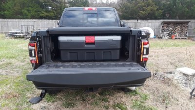

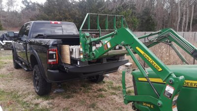

This is a method for smoothing out the ride of my 2020 PW.
The PW has an amazing ride already, but this 500 pound mass made her even better.
This also helps keep the wheels down in the mud.

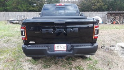

Next, I'll strap it down to prevent jumping and also readjust the headlights as a bit of squat raised the cutoff.20201212_140139.jpg 20201212_140914.jpg 20201212_141443.jpg 20201212_141633.jpg 20201212_141657.jpg

Did you do this for better traction? Are you getting stuck offroad? The weight will surely help driving in snow.

Hi Hall... well the word "stuck" never applies to a Power Wagon... haha!
Truthfully my PW is a "Pavement Princess". A daily driver and part-time woods truck. The extra bed weight does help with traction in mud and snow. It shines when pulling out Chevys and Fords...ha

I mean I guess that’s cheaper than putting the right tires and suspension on and fixing your concerns the right way...

Gotta be honest man, while this is smart for off roading, not smart for daily driving. You're gonna have to really secure this to the bed with some heavy hardware. If you get into a bad accident and this is loosely secured it's gonna become a missile and tear out of the bed and blast through your cover.
If you're wanting a smoother ride, while it's more expensive, I'd look into suspension and tires.

I actually think it is equally bad or worse for offroading. just air down the stock tires to about 35 psi in back and 38psi in front and ride really smooth. it has to hurt mpg a bit too in daily driving.
Having added weight in the back while off roading isn't necessarily bad. Helps with mud and snow, but yes airing down will help also. I've had to load the back of my truck with a couple bodies when I got into some really bad red clay mud and had my tires at 30psi.
