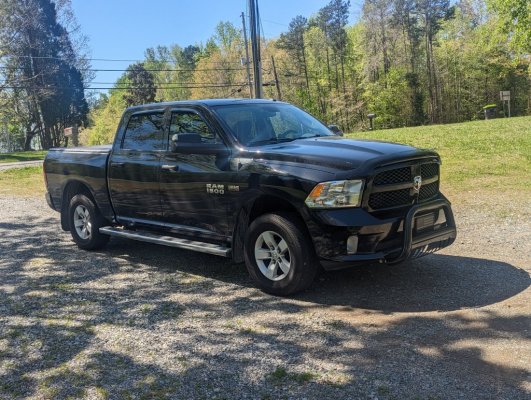

Trying to figure out what tires to get. 285/70r17 too big. OE is 265/70r17. Recently added 2 in leveling kit to front of truck. Can't afford to buy new wheels so trying to figure out what a good size without looking ridiculous on stock rims. Any advice would be appreciated!

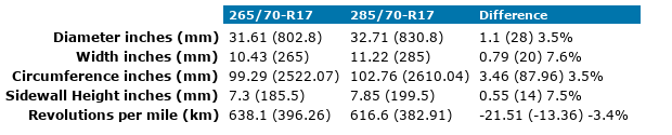

You'll have no problems with 285/70/17 on your truck, lots of people upsize to those. They're actually similar in diameter to the stock 20" tire that came stock on the Gen4 trucks.

The speedo will be off by 3.5% so when going 70 mph per the speedo you'll actually be moving 72.5 mph. Same goes for mileage. The speedo can be adjusted using AlfaOBD.

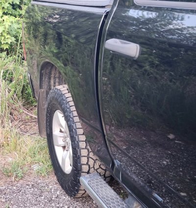

Im currently Running 285/70R17 K02's on my stock 17's with no level kit, they rub the slightest bit when im turning full lock to either side.
When I have my TT on the back, the front is pulled up to level and they don't rub at all.

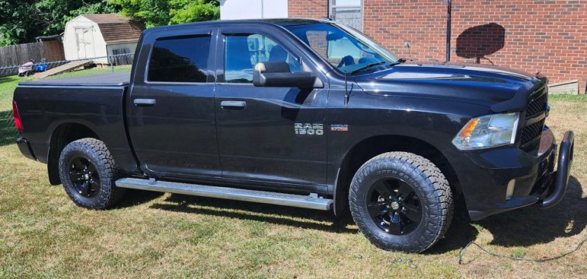

Decided to go with Toyo Open Country AT3's. 275/70r17 . Also added some wheel skins. Thanks for all the input.
