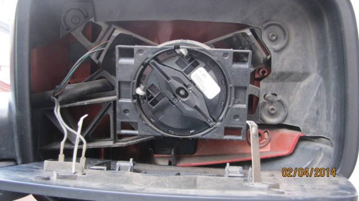

This may work for you to remove your broken mirror, if it is a regular non tow type
First tilt the mirror down using the mirror switch
Put on some gloves or use a rag to protect your hands
Then take your index & middle fingers of both hands & put them over & in back of the mirror glass
Then take your 2 thumbs & put them on the face of the mirror glass
Pinch the mirror glass & give it slight jerk towards your chest, if it did not pop out of the upper clips, jerk it a bit harder until the top part of the mirror glass is loose.
NOW, look behind the mirror glass, mostly too see how the bottom hooks are attached & look at the 2 metal fingers & how they fit to the tilt motor.
Now lift gently as you jiggle the mirror glass & it will lift out.
Now you will need to undo the wiring clips & you are done.
Save the 2 metal fingers, because you will need them on the new mirror glass

I find if you power mirror glass all the way in you can get a small screw driver in between the mount to help start this process. I pulled mine apart a few times swapping back covers when i had them color matched, the passenger side on mine did not pop and instead the motor behind it went too far. Kinda gave it some more play which bothered me so i found another mirror.
I do have a spare glass with all those options but the metal tab holder has one broken side on the mount, easy fix with epoxy.
