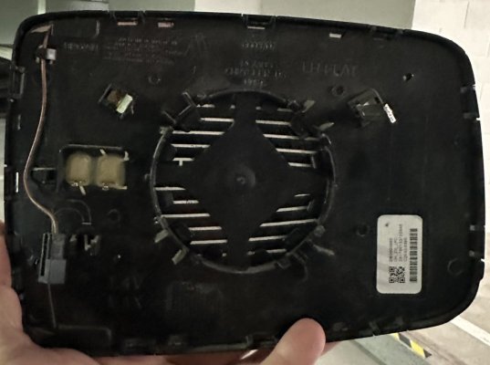

This is the back of my side mirror glass. You can see the connection is different than the mirror glass that you sent me. That is what makes this so difficult, that they show various parts that they say fit my model year, and I found that they don't.
Yeah definitely different. Sorry dude.
