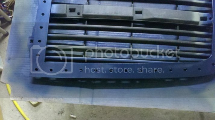

Well, the rustoleum primer is great....... the actual color...... not so much. Can this stuff be bought in quarts? Im out of paint so gonna have to wait till Monday to get more spray if I can't get a quart. I know a guy that restores classic autos that im thinking of having spray the rings. The shell looks good too, just the damn rings are givin me issues.
Its spotty. Like there are glossy spots and dull spots

Which line of their primer did you use, the Automotive primer? I think thats only avail in spray cans.

yep, the automotive self etching. it worked awesome. it's the dinky ass cans of the lacquer paint

I have never used it personally.....I have always stayed with Duplicolor myself. My dad's 76 Chevy truck was primed with RustOleum via a damn roller...how many coats of the primer did you do? Did you sand the primer before the top coat?

dealer is about 10 bucks a can. You need to paint when its not humid out, thats what may be causing your blotchiness. and CLEAR it. It will remain "flat" looking if you don't.
