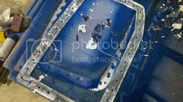

slight adhesion issue

What kind of primer? What form of prep prior to spraying?
My advice? scuff it up with some 400, use some self etching primer (on that metal) - let it dry for a day, then lightly scuff with red scotchbrite and hit it with your color coat.

Yeah the tactical. I was usin plain rustoleum primer. They have an etching primer also, would that be ok? Prep, whats prep lol. I did sand it, not sure what grit. And cleaned it with windsheild cleaner, all i had. The stuff said it had to cure for 48 hours. Read that after i had put it on lol. Thanks JJ you da man!

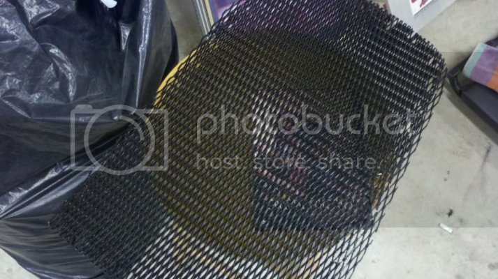

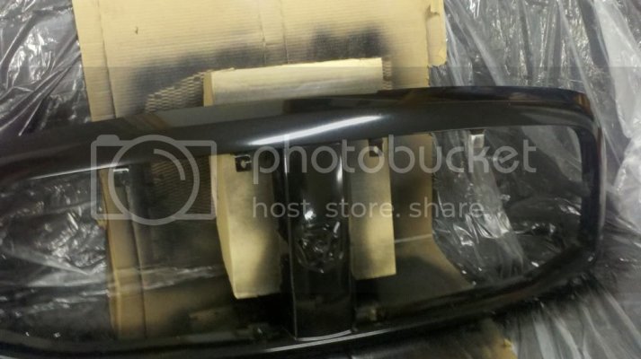

Black shell, matched ring, black mesh. The mesh is done, gotta do the shell another time or two. Then put it back together and not scratch anything lol.
