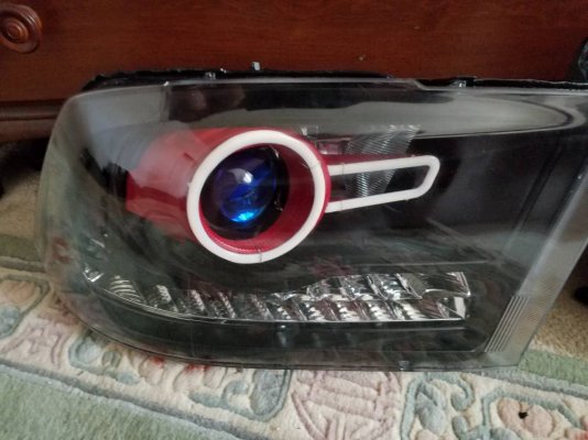

Thought id share a pic of my lights im slowly working on. These 16 headlights are way harder to open then previous ones

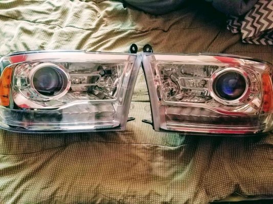

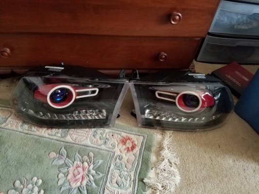

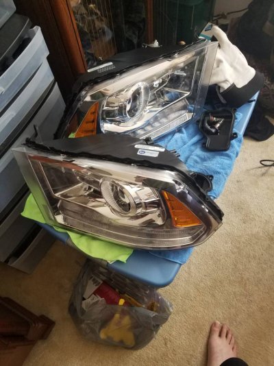

I see the black housings on yours took a beating too. So did mine. I'm doing the 13+ OEM Projectors and man were they a pain in my ass to open.
They wouldn't fit in my oven so I had to open them by hand with a heat gun lol...
7677db281ef6393e467ca226773765a7.jpgf2a09b77bc66fdd05f7ae89a6fb99464.jpg1fc1b58f08d34143a892273084ed6238.jpgd7ebf922e7970d7989ee63086af1ba17.jpg5f2090a004fe819663318cf2dbfc38ce.jpgeed0c2b6307fcb443a5071869288c587.jpg
I eventually got them open and afterwards I used the heat gun to warm the housing edge's and mold them back into place so they look pretty much normal now. I was worried when I first got them open how bad I demolished the lips but thank God they formed back with a little heat and some plyers.

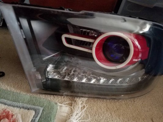

Did you happen to chew up and bend the black part of your housing when you took yours apart? Or were you lucky and got them open with minimal damage?
I had to heat my "groove" back up, and bend it back into shape with pliers. The groove where the clear lense sits in. It was all wavey and bent out of place. It looks almost perfect and normal now that I heated it up and reshaped it, just curious if this happened to you too. Seems the OP had the same problem as me. To hell with small ovens and Permaseal!!

I did good. Acouple pry marks I bent back. Just had to keep hearing it up and take time
