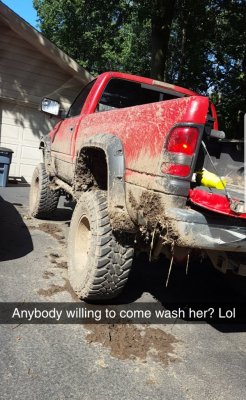

Figured for only about 150 more it's worth getting the extra 2inches. Plus my other truck has a 10in lift so not sure if I would be happy with only a 4inScreenshot_20180212-234324.jpg

That makes sense, nice ride btw I really like that red truck body style. I have looked into getting a 6" lift but I am not sure if it would be the best for me since I do a lot of driving on the weekends.

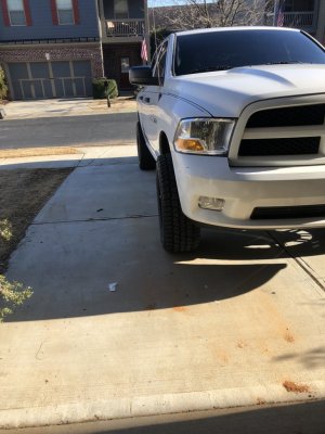

Sorry for the bad photo, took this on my lunch break, but this is how she sits now. And no I don't think there will be a huge difference between a 4 or 6in lift. IMG_2194.JPG

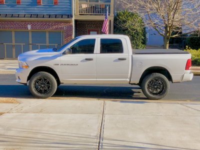

Hey this is my first post here but I have a 2012 1500 that I just put the 4 inch Rcx lift on. Mine is only two wheel drove but she is just a daily driver that I put a lot of miles on. The wheel and tire recommendations for both kits are the same. I got 35 inch Mickey Thompson Deegan 38 at and I went with a procomp blockade 20x9.5 wheel with -6 offset and 5 inches of backspace . I get zero scrubbing and I’m really happy it.

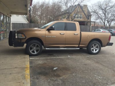

Here’s my 4” BDS on 35”s. I have Bilstiens on the front at 1.4”. The front actually rose 5.4”. Most people ask if it’s a 6” lift?
