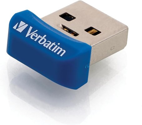

This is how I have my songs all the time, any I buy I put on the usb thumb drive and plug it in, in my truck the usb I use is inside the center consol arm rest. I use this style of thumb drive it doesn't take up much room and nothing else pushes it while in that box
