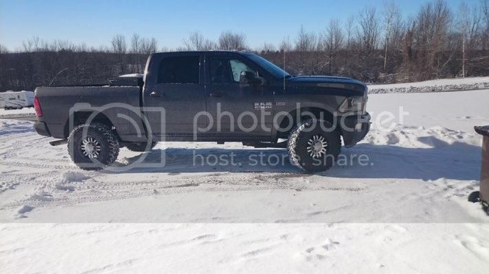

Most will tell you that spacers ruin the ride quality. The last 2 out of 3 trucks I've had I've used spacers and felt no real change in ride quality. Rough country sells a 2 or 2.5" (can't remember off hand) spacer for around $100. Hell bent steel runs around $150. I've been considering 2 different traxada (probably spelled wrong) kits. A 2.5 front 1" rear for around $250 or a 3.5 front 2" rear for around $350. Only problem with that one is you'll need adjustable Trac Bars which will push the kit closer to $1000 if you do front and rear adjustable Trac Bars. As far as whether to go spacers or actual lift really depends on budget. I didn't see what year your truck is but a 4th gen will clear 35's mounted on a set of aftermarket wheels with a +18mm offset and have just a little rubbing with no level.
Here is a pic of my truck stock height with 35's w/+18mm wheels before I should them.

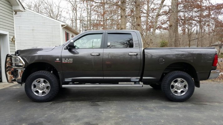

I put the 2" hellbent spacers and 35's on stock wheels. The ride is still great. The front is a tad lower than back. Picture is deceiving since my driveway is sloped.bd653fcb28194c9779eadc0edc59e490.jpg

^^^ Used the shock extenders that came with the HBS kit. Worked out great. Truck has no pull to one side or the other. I'm sure the 2" leveling kit caused the axle to move both to the drivers side and rearward, really haven't noticed it. Steering wheel was off maybe 1/2", but corrected with the alignment. centered now.
I've put over 4K miles on the truck since. including a 2600 round trip. Rode great. I did lose about 2 MPG with 35's vs factory.
