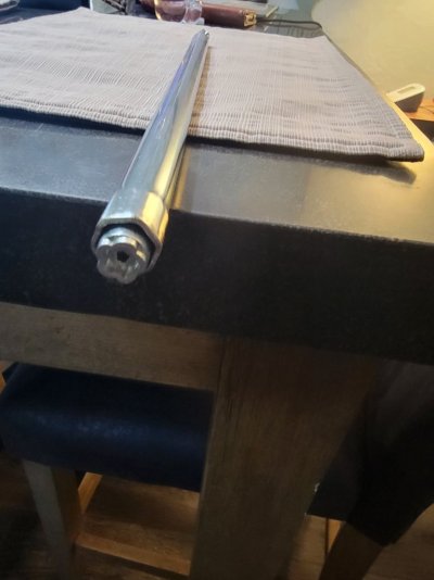

I was having the same problem, in my glove box had a separate rod in bag as long as the black rod.
