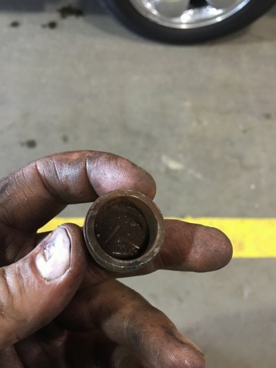

End of last year, my 2010 3500 dually was squeaking while backing up too. Just a little. Totally forgot about it until couple weeks ago. After pulling 5er three hours, and unhitching, truck would vibrate slightly when slowing down. Took it to my local garage and my mechanic said rear U-joints were notorious for going out on these trucks mainly because of the angle. He dropped the shaft and checked them out and sure enough, rear joint was bad. Replaced and all is good for now.
