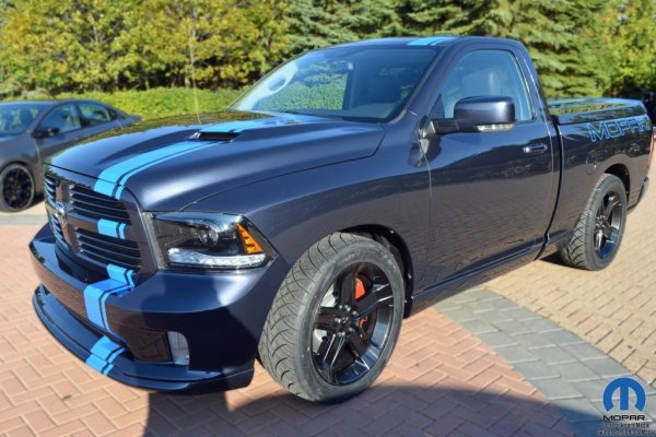

If you have a 2wd you can adapt the earlier SRT-10 brakes. 2wd spindles haven't changed from the start of the 3G run to at least the end of the 4th gen run; SRT spindles are just slightly different 2wd spindles. When Mopar made the 4G based Urban Ram concept for SEMA back in 2012, they used the earlier SRT spindles to mount a set of '05-'06 4 piston calipers to it:
If you can find a set of spindles, you have the option of these or the 2004 calipers (big 2 piston sliders from the 2500 trucks painted red), which are cheaper and easier to find. Both use the same 15" rotor. Due to the difference in how/where the UBJ attaches, the alignment would have to be adjusted a bit (SRT trucks were aligned different than regular 1500's with a combo of the spindle and different LCA's).
