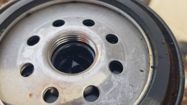

I just ran into an issue like this servicing my Dad's truck. Long story short, the rear filter was defective. Actually I suspect he bought a chinese knockoff since some of the writing isn't the same as the old OEM.
So what to check, remove the NEW filter. Inside the threaded hole you'll see a plastic piece that needs to stick out far enough to press the plastic ball check valve that is in the center of the filter head. On his it was way too deep and not opening the check valve.
Another guy I know just experienced the same thing so its going around.
Let us know what you find and if you can compare it to the old filter for comparison.

Tooo filter off new filter is about 1/4 to 3/8 of inch deeper than the one I replaced going to get a new see see if that works

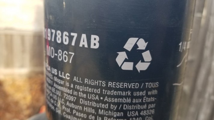

If you can post these 2 pics. This is an authentic filter. Compare the depth of the plastic piece. But also look at the printing of the Recycle symbol. Does it look "off" in comparison? Also did you get your filter from a seller on Amazon? That's where the fakes (or defective)
have been coming from.

Amazon is starting to sell a whole bunch of knock off parts as OEM. I would bet money they know this is happening and are doing zero about it. Surprised big makers like Mopar aren't going after them for this.
18CrewDually
Nov 17, 2019
2,421
3,418
U.S.- New Jersey
Cummins 6.7 H.O.
Yup. You got the same fraudulent filter my dad got. Look closely you'll see the printing is different and again that recycle symbol is not right. Dead giveaway.
My father contacted the seller and he did give him a refund.
This isn't necessarily Amazon, it is the vendors listed with Amazon that actually is supplying these fraudulent parts. Unless it comes from a dealer it's hard to trust. Remember if the price is too good to be true, it probably isn't.
