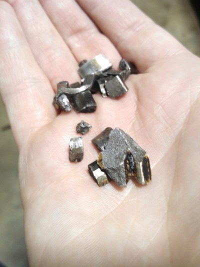

"Welp, there's your problem"
All that shrapnel is bits and pieces of the cylinder #7 Piston. It appears to me that a valve seat broke loose inside the combustion chamber and wreaked havok. All the valves seemed to be present when i look at the engine, but they didn't take the heads off. When they pulled the air breather they could hear metal shrapnel jumping around in it when they moved it or shook it.
Image was shaky because it's a picture of a video with two people holding each unit, but even then you can see how pitted the piston is. Cylinder walls are probably *****.
Has anything like this ever happened to anyone else? I've heard anecdotes about similar instances with the #7 cylinder, but i assumed these were pretty rare.

Usually I recognize at least some of the shrapnel when shown, I don't recognize any of that mess. There is a good chance the head is scrap, but often the block can be sleeved. Good luck..

The biggest piece found shows the ring lands on the piston. Something must have hit it hard. Some smaller pieces show the smooth outer portion where the piston is flush with the cylinder wall. There are a few smaller pieces that look like they could be a part of the valve seat. I'm going to try to get them to rip that head off tomorrow so i can get a good look at it, even it it's just for giggles so I can see the extent of the mess.
Apparently this is a fluke and nothing I did would have caused this or prevented it. I happened to pick the one hemi with some sort of flaw in that part, I guess.
