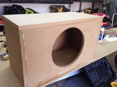

Well I wasn't happy with the box I previously built. I made it a bit too big deep wise, and it hits my seat a bit and forces me to moves forward about 2 inches. So I made the decision to make a new box. I designed it all in a 3d CAD software, and used other calculators to figure which size and style would suit my sub the best. 1.8 cubic feet plus a 3" port with a length that will make it perfect to tune to 40htz.
Here's the start we got on it today. I regret not taking many pictures, I'll get more tomorrow when I carpet the box.
This is the jig me and my friend made to cut out the hole with a router.

This should fit perfect behind my seat. I'll see if I can show you the plans from the CAD software. Yes it'll hold a 12" Kicker CompVR. I used all those weird specs for subwoofers in a special software that shows how it'll perform in a box of a certain size and tuned to a certain Htz.

Is that box square or does the front lean back? I can't see in the pictures.
It's looking great, I'm excited to hear about your results.

No It's perfectly square, I think my angle on the camera made it look distorted.
I should be getting some carpet on it today. Hopefully all the wood glue dried. I sealed every edge inside and out with dobs of glue. So if my friend can bring it over, I'm going to sand all the joints smooth with my orbital sander, then get to carpeting.

Are you planning to countersink the sub before you carpet the box? Just a suggestion if you were not considering it. Flush mount 12's sometimes have a tendency to have the baskets resonate when they are not countersunk. This is usually due to the air pushing past the baskets that are flush mounted by only 4 screws and leaking at the rim. Countersinking the sub by 3/8's, assuming you're using 3/4 GIS plywood, would rectify the problem.
NO criticism intended. Used to install mobile audio for a living.

No, not counter sinking it. This wood is only 5/8" and adding a countersink won't give it much wood to mount onto. I could probably build a ring to go around the sub then fiberglass it, but I really don't have time. I just want to get this done honestly. I plan to carpet it at least by tomorrow afternoon, and by the evening it should be ready to install.

No point in building a ring, it's counter intuitive, especially on a ported box.
